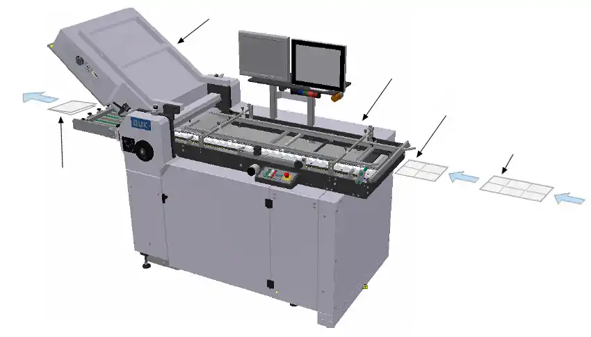

F-200 buckle folder showing sheets fed into and out
Upper
Fold plate
Folded sheet
delivery into
Smart-binder
Infeed register
conveyor
8-page
sheet
12-page
sheet
Sheets arriving from
dynamic web cutter
F‑200 cross-folder unit used directly before SB infeed
